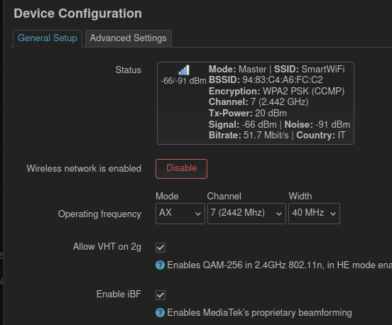

Which firmware? Stock GL.Inet, OpenWrt, or pesa1234 community build? You would be best off with the pesa 4.4.x community build. I saw unexpected slowdowns on OpenWrt 24.10 when other devices would leave the network (e.g. my wife and her iPhone left the house to go shopping). Restarting WiFi brought things back to normal. Never encountered that on a pesa build.

This seems to be fixed on 4.7.4 BETA build.
Edit: Scrap that, still goes weird. There's a test build kicking about on their forum which supposedly fixes it, and it's that which will be released in the next 15 days or so
Again - note this is the Pesa community release...
Here's the community support thread...
For the moment - on MT6000, I would go with the 24.10 stable release first, as everything there is aligned, including the SW library.
