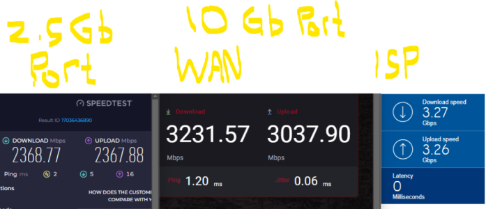

If you set the 10G port for WAN, then the 2.5 G port will work on LAN.
I just bought one of these and did it.

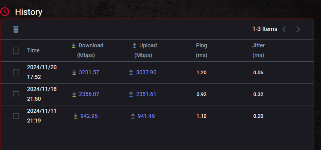

The pic shows (right to left) the speed of my ISP router HH4000 3Gbps service, the "Internet Speed" on "Game Accelleration" of the AX11000 Pro, and on the far left, which is routed through a 2.5G switch to a 2.5G ethernet port on my PC.
I previously fed the ISP 3 Gbps service into the 2.5 G WAN port and got the 2.5 G speed on WAN.
Notice the port status shows 10G is connected to the internet. I have the 2.5 Port feeding a 2.5 G switch. Never mind LAN3, it is on an IOT device that just has a 100 Mbps connection, so the router flags it thinking something is wrong lol. Same thing will happen for a PC that is in sleep mode and low power on the LAN.
