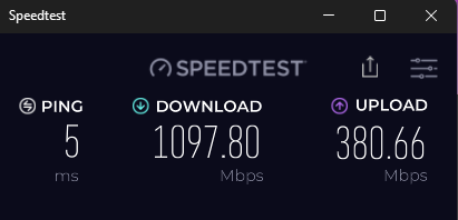

At least you can get MLO to work on Win11. I have the same router, same Qualcomm adapter and MLO has not appeared to work at all for me. Not to mention, my upload speeds aren’t even close to matching my symmetrical 1Gbps WAN, even though PHY speeds indicate a quality 6Ghz link..

On a side note, do your upload speeds look similar to mine (~300-400mbps regardless of quality 5764mbps PHY link) or are yours looking as to be expected? Using MLO network or the main SSID yields results within margin of error, so I'm stumped. Running the Speedtest through the router indicates I'm truly getting 1Gbps up/down via WAN port, so I'm quite puzzled as to why this is the case, did I maybe get a lemon? My Google Nest Wifi Pro was performing better..(albeit with less range).

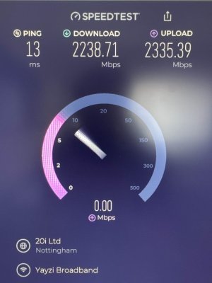

So I’m leaning towards my Intel be200 being possibly faulty as my new WIFI 7 card is giving me between 1900-2300 down/up. I am going to keep an eye on it

This I really weird as I thought it was a dodgy wifi card a couple weeks ago but thought nothing of it. In a way I’m hoping it is the intel card as then at least I know my ASUS gt-be98 router is working how it’s meant to be.
