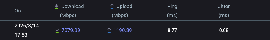

If the PC is connected to the 10G Gaming port, WAN upload is limited to about 1 Gbps.
If I move the exact same PC / same cable / same NIC to a 2.5G LAN port, WAN upload goes up to the expected ~2 Gbps.
So the issue appears to be specific to the 10G Gaming port.

- 10G Gaming port -> ~1 Gbps upload
- 2.5G LAN port -> ~2 Gbps upload

What is the link rate detected/negotiated by the ASUS and PC while plugged into the 10 Gbit/s port ?
If you use the 10Gb REALTEK nic, what is the link rate negotiated between the PC and the ASUS 10Gb port ?
If it doesn't sync at 10Gb/s something is physically wrong or drivers.
2.5 Gb is an oddball for compatibility. You may be able to place a non managed 10 Gb switch between the two and solve the issue.
