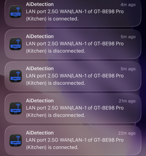

In this build ASUS mentioned about the improvement:
Enhanced stability for 2.5G LAN/WAN port operations.
I see this issue on my mesh node always. Hope they fixed it really.

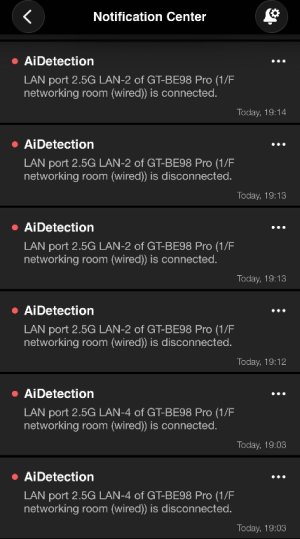

Same here 🤞
