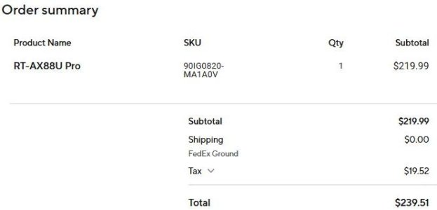

thanks everyone for chiming in. please don't be annoyed I questioned any generously offered advice as I have simply been watching from the sidelines for years till my 10yo AC finally showed it's age. I hold the group think from regular contributors here in high regard. I'm glad there still was no support for going wifi7 in merlin'land once you read my "wish list". I'm glad there was no descent over the AX88U Pro choice, despite it being way over spec'd and at the high end of my budget.
I somehow got lucky and scored a brand new unit direct from Asus for $220 free ground ship plus state tax and could put it on my credit card so I won't feel this kick in the nuts all at once. I checked price history tools and know these were selling new for less, but that's in the past, time to buy smart for the next 5-10 years of wifi to keep my 4 adults (many home school or work from home) and their "what's your guest pw" friends happy. my only regret is buying before wifi7 had matured.
