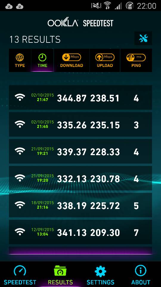

These are my rates over wifi 5Ghz AC, using galaxy s5 and ac87u with 9177 firmware...
I'm sure that a macbook pro could do more...but on wifi aria there are so many variable...
Try to stop any traffic analyzer, qos and check the connection speed. Do some test with basic configuration of the router to have a refference point. AC68U should have even better stability on 5Ghz than ac87u so you should have close to 95Mbs...
