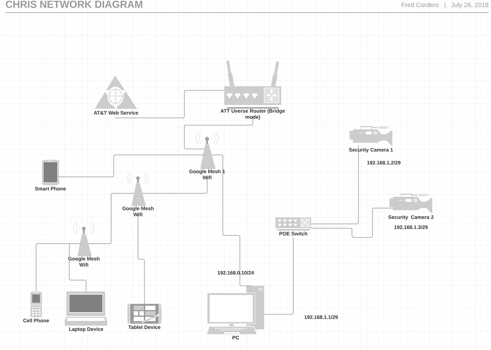

Hi. I hope you can help me with my setup. This is an illustration:
Network details:
- ATT fiber 1 gig up/down
- 4 Google WiFi connected by ethernet
- 1st Google WiFi has routing duties
- Google WiFi has no VPN server capabilities
- a dedicated PC with Blue Iris software with 2 LAN cards: a secure network connected to the rest of my network and an insecure network connected to POE cameras
- this PC is always on
The good folks at IPCamTalk.com suggests running a VPN server because my iPhone will only be able to connect to my Blue Iris PC and view images IF IT THINKS IT IS STILL IN MY HOME NETWORK.
Any suggestions on where to put a VPN server in this setup?
I am tempted to replace my Google WiFi with an Asus router but I hesitate because I actually like the Google WiFi.
I am not familiar with your specific devices (ATT and Google) but logically a VPN server would be on an always-on device on the 192.168.0.x subnet.
Your diagram shows the ATT router being in bridge mode but there must be some device on the network that is acting as a router, gateway, DHCP and DNS server (Google Mesh 1?). The VPN server might be able to sit on that router. If that's not possible then that router would have to be configured for port forwarding to another device on the LAN (which is running a VPN server).
If the PC at 192.168.0.10 is always on you could install the VPN server on that and port forward to it.

@ColinTaylor: Thanks! Your assumptions are correct. The 1st Google Wifi device is doing the routing duties. Unfortunately, Google WiFi has no VPN capability.
The PC connected to the cameras is always on.
I could install a VPN sever there as you suggest. Any software recommendations? I hear about OpenVPN but I don’t know how easy it is to set up. If cost is not an issue, what’s the easiest way to do this for a non technical person.
OpenVPN would be the software of choice IMHO. But I've no experience of setting it up on a Windows PC. I should imagine it's fairly straight forward.
