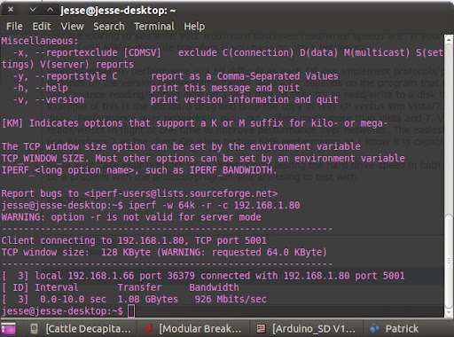

I ran iperf again with the arguments you recommended, here's the results:
https://lh6.googleusercontent.com/_ff-oJr7H2G8/TViRcKcNi7I/AAAAAAAAAFk/fbd_3-PNzto/iperf.jpg
926Mbit, so that's still all good.

Iperf still looks good... the -r option should give you two results. One to the server and one back from the server. I think you need to move the -r option so it is after the -c option. I usually us a command line like iperf -c 192.168.0.2 -w 64k -r.
Those iperf results are a bit hard to read... I probably should have given you a command line to run. I generally use a command line similar to this:
