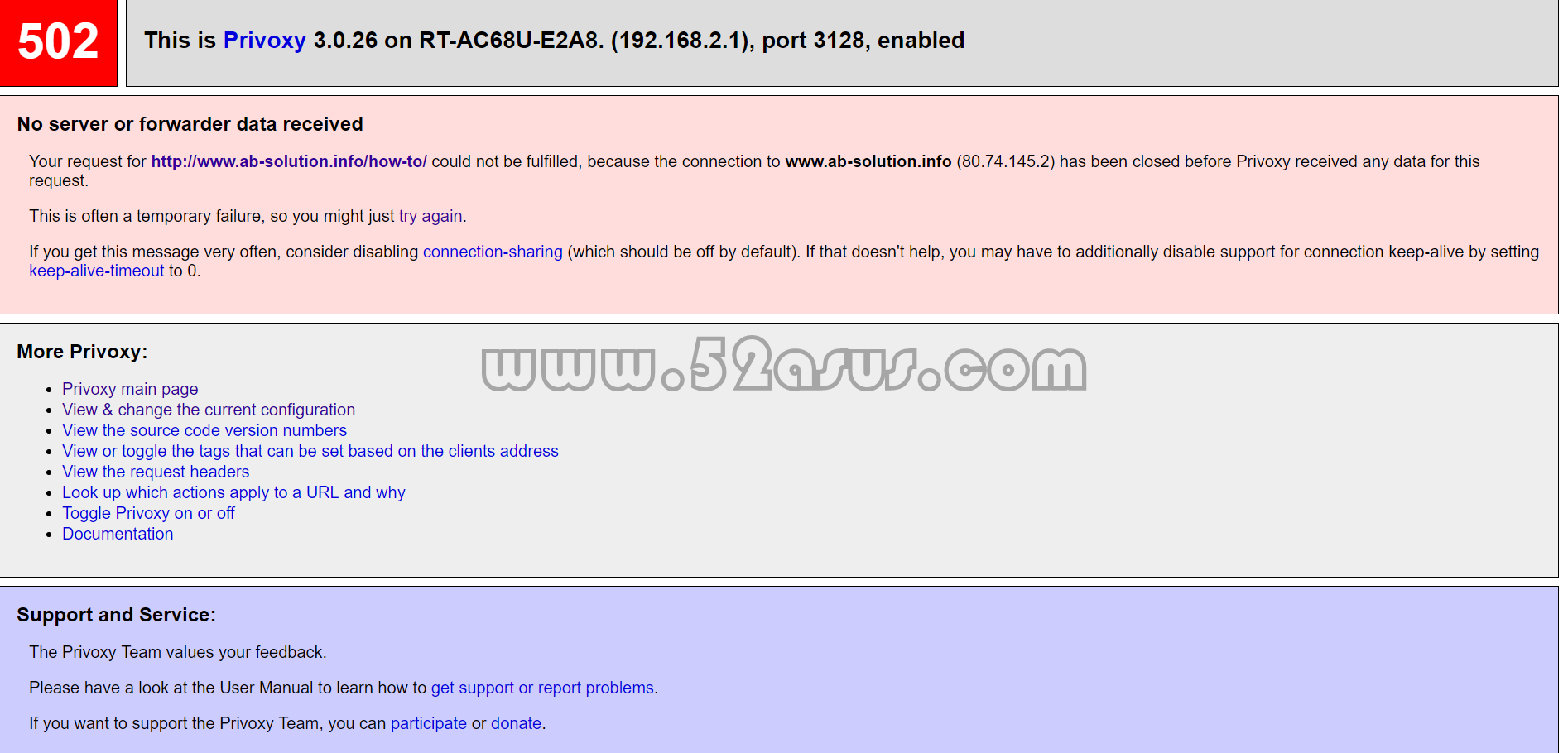

Has anyone solved the unavailable ressource error? Even after changing my ulmit -n and -s to 4096 in the startup script as well as adding a max-client-connections 512 to the provixy config I'm still getting these entries in my privoxy log:
Error: Unable to take any additional connections: Resource temporarily unavailable. Active threads: 40
The system log isn't being helpful either and both memory usage and CPU usage never go higher than 50%. I'm wondering if the problem may have to be with my USB drive being a USB key...
Anyone have any other ideas?

Just in case someone really needs privoxy and is running into the unavailable resource message, I ended up lowering my maximum-clients configuration setting to 38 and it works fine now.
