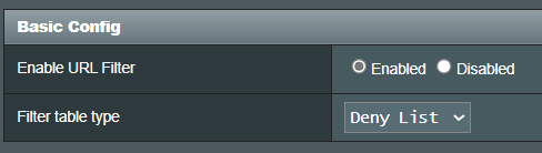

Just asking the obvious question: You have "enabled" the URL Filter (I couldn't see that information in your previous screenshot)?
there was a brief moment that i doubted myself but unfortunately it was enabled
that's indeed blocked
i thought i needed to do it from the router
just realized it also wortks with only parts of the site/domain.
i typed in samsung and finally the tv update procedure gets blocked
this means the site samsung uses for updates has samsung in their dns name(but it was not the onces i previous used)
