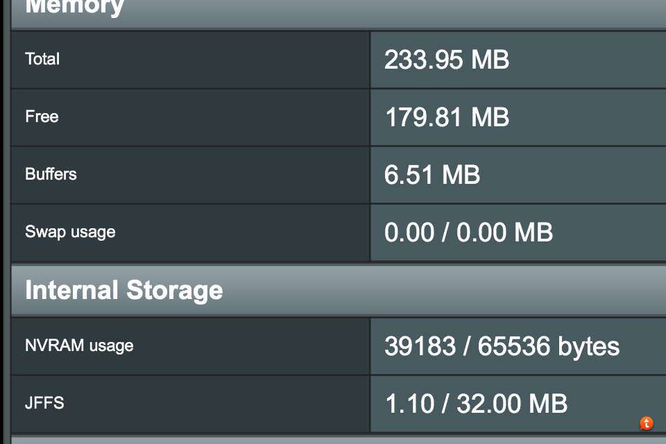

Is my NVRAM right? Here a picture
Sent from my iPhone
Looks OK.
Mine is: NVRAM usage 42340 / 65536 bytes
