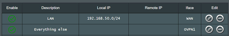

Given my previous post I think what you're asking for is this:
Where 192.168.50.0/24 is all LAN devices (not the router) and "Everything else" would be (by process of elimination) the router.
Hi Colin
Thanks for the response and what looks like a successful solution.
I had initially tried this but put the routers IP in and when calling using ssh wget to a whats my ip address i was getting the WAN.
However with this I am now getting the VPN by your simple suggestion of putting nothing and the rest of my LAN is not being impacted by this VPN.
