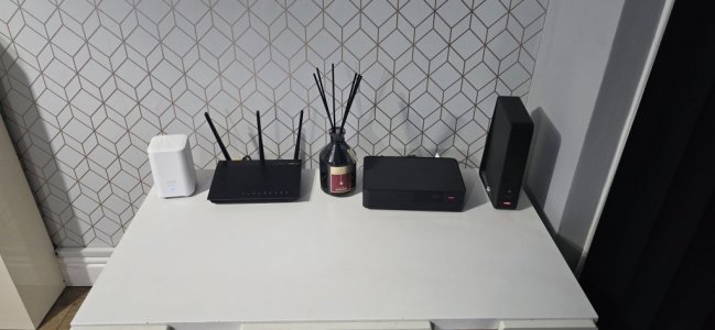

It's in router mode. As I put the virgin one into modem mode as I get better signal with the Asus.

The coax comes from the inlet to the house into a 3 ways splitter. Which goes into the back of the virgin router and the ethernet out goes into the Asus living room router
I wanted to know what device your MoCA adapter is plugged into.
Yes that's why it's in modem mode? To feed the Asus router next to it
Interesting, I thought you said both routers was in a different room from the modem.
So it looks like you need to set the upstairs one to AP mode and plug the moca transceiver into the router next to the modem.

so I quickly drew this. This is how downstairs is set up😂😂
Into the virgin one mate I had to have a look lol
The MoCA adapter should be plugged into one of the Asus router's LAN ports.

That might cause problems depending on the particular MoCA adapters you're using. We'll see. But you must only plug the living room MoCA adapter into the Asus router's LAN port (because the VM Hub is in modem mode).
The alternative would be to change the VM Hub back to router mode (with Wi-Fi disabled) and put the Asus in the living room into AP mode. Then it wouldn't matter whether the MoCA adapter was plugged into the Hub or the Asus.
