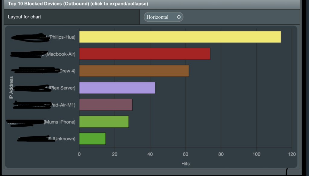

Why is Skynet saying it is blocking these devices, should I do something to stop it from occurring? Or is this just how Skynet blocks certain outbound traffic?

SSH into your router and see the stats. Or click the OTX link for IP indicator. Someone will advise you that built in router is good enough if you dont have the time to troubleshoot whats broken. Anything broke/not working?

That Phillips-Hue looks like IoT blocking. I have Philips-Hue bridge on YazFi Guest one way Samsung TV. There were huge inbound/outbound blocked from my Samsung before

No everything appears to be working fine so far, I’ve got some countries blocked so maybe it’s just some servers these devices are trying to connect to.
It means those blocked outbound are initiated from these devices.
Sorry, I’m a noob when it comes to firewalls, what do you mean by initiated? The devices themselves are being blocked?
The blocked outbound packet is coming from one of the devices in my home network. Not everything from this device is blocked. Only the outbound packet that matches the rules are blocked. Other than top 10 blocked outbound IP addresses, it also record the top 10 devices which has outbound packet blocked.
Here is a sample the other day when it hit the outbound blocked destination IP 34.117.59.81. It also record down the source IP 192.168.1.91 which is my laptop.
Jan  3 16:00:45 RT-AC86U-DBA8 kernel: [BLOCKED - OUTBOUND] IN=br0 OUT= MAC=xx:xx:xx:xx:db:a8:xx:xx:xx:xx:00:01:08:00 SRC=192.168.1.91 DST=34.117.59.81 LEN=52 TOS=0x00 PREC=0x00 TTL=128 ID=41445 DF PROTO=TCP SPT=63067 DPT=80 SEQ=1282142074 ACK=0 WINDOW=64240 RES=0x00 SYN URGP=0 OPT (020405B40103030801010402)

Ok, I see. Thanks for explaining that.
