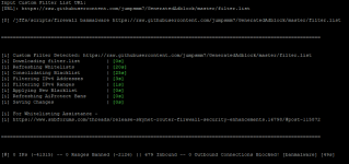

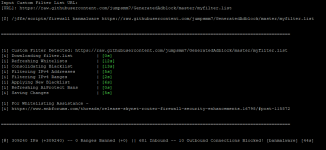

When I want to use @SomeWhereOverTheRainBow s custom filter list, I get 0 banned IPs:
Any suggestions why this is happening?
It was working good, before I tried some other lists mentioned above.
Then I decided to switch back to @SomeWhereOverTheRainBow s list, but it's not loading IPs...
Thanks, but Skynet says, your first link still has 0 IPs.
The second link does have ~ 300.000 IPs, but no ranges.
Thanks!
This link is working again, but is not blocking any ranges. It's blocking ~200.000 IPs, but no ranges.
The second link is also blocking about 400.000 IPs but no ranges.
Some time ago, your filter list also included ranges.
Not sure what to tell you, unless iptables is not cooperating with the entries. Or maybe the list that is no longer any good was the list that had all the ranges. Tbh most of the lists don't list ranges, they only list the either subnet form or straight ip form.
Screenshot 1 is your list - 0 ranges banned
Screenshot 2 is Skynet default - 2055 ranges banned
