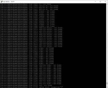

Suspecting something is wrong with AdGuardHome, I tried to open AdGuardHome via amtm to reinstall or repair it but immediately after the startup lines, multiple lines error text started to flow through the screen rapidly and the AdGuardHome script exits automatically. There were so many error lines that I am unable to scroll back to the top in the putty ssh shell.
A portion of the end of the error lines is inserted below.

Try
curl -L -s -O https://raw.githubusercontent.com/jumpsmm7/Asuswrt-Merlin-AdGuardHome-Installer/master/installer && sh installer master uninstall
