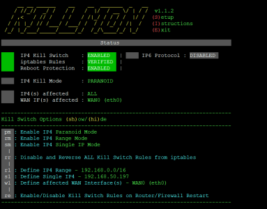

New to this, does this look right
Thank you again, is this the most secure way to use range mode. i have nordvpn and skynet
Paranoid mode blocks everything. If you only need 192.168.1.50 - 192.168.1.60 blocked, you would use range mode. And everything that falls between that range would get blocked. I use Nord and Skynet as well... so just be aware, if you make big changes to Skynet, upgrade it, what not... that will cause iptables to get reset, and you would need to re-enable killmon. Just keep an eye on it. I have plans in the future to make it a bit more automated, and have it do stuff like this on its own.

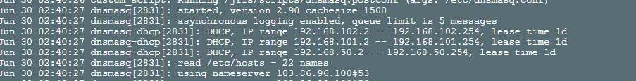

With guest networks, would the range 192.168.1.50-192.168.102.60 be a safer option globally.
That would definitely need to be tested. The only examples I have ever been able to find show that the iptables command can only handle an IP range in its own subnet... Like 192.168.1.50 - 192.168.1.100. You would likely have more luck with the CIDR notation (192.168.0.0/16), but that also eliminates any precision in the range.
While it looks nice to keep things separate in their own subnets... is it realistic that you might possibly have to dish out 250 addresses in each of those guest networks? Or do you think you can find 10 for each, and fold everything into your 192.168.1.x network? That would probably be more realistic.

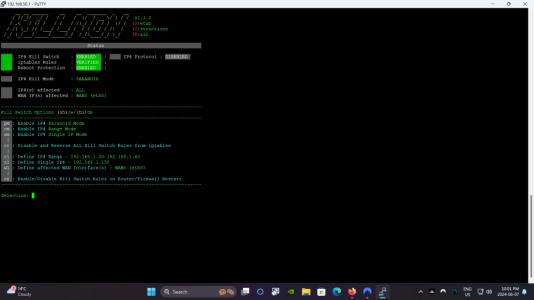

Last thing before I go, 192.168.50.1 is my network, and ipv4 only network. Is the single ip 192.168.50.197 best for this type of setup. Again thank you, Pretty new to this.
A single IP would be the only IP blocked by the Killswitch if your VPN goes down. That means everything else will be able to get out over the WAN. I believe in your case, you were leaning more towards using it for a range with a /16 CIDR subnet, right?
