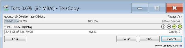

Working a lot better now with your firmware:
92 MB/s per second on SMB Write.
