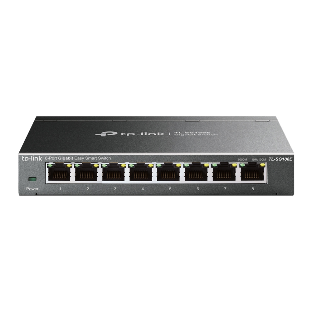

Look at TP-Link TL-SG108E
I have two of these switches in my network setup and in looking at the switch's firmware I don't see anyway that this switch would function correctly in a network without a router. What the OP says he wants to do is connect the recommended switch directly to the modem and acting to his firewall and also the switch would need to have the ability to act as his DHCP server. I suppose there might be an updated firmware that could do this but nothing even close is possible in the versions of the firmware that I'm running.
@CaptainSTX Sorry, missed that part of the OP's requirements. That would require, at minimum, a Level 3 switch. I have no experience with them, so can't advise, but it seems like an unnecessary complication to me. Maybe @Trip can comment.
That is why I bowed out of trying to address the OPs needs. No experience trying to make a network function without a router or by using a Level 3 switch and have it handle the functions normally handled by a router.
