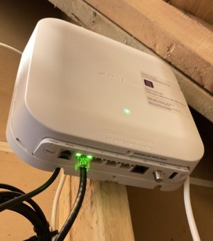

Using RT-AX86U as router, the ISP (Telus) Network Access Hub I only use as a modem, therefore bridge mode.
I used to set the 10G port as the bridged port but now switched to LAN port 1 as bridged 1G port (on 1G plan so makes no speed difference)…
Not thinking its a modem issue since the router worked totally fine again after a reboot…

Reset fibre modem, put in bridge mode again using LAN Port 1.
I only switched to the new ISP (Telus) fibre internet a couple months ago, before had Shaw (Rogers) cable internet…
Not 100% sure but thinking I had weekly issues where the router rebooted automatically (got emails saying the NAS lost connection…) but yesterday was the first time where I had manually reboot the router to get internet…
Router almost 4 years old and haven’t factory restored for more than a year, its working now but should it give issues I’ll factory reset…
