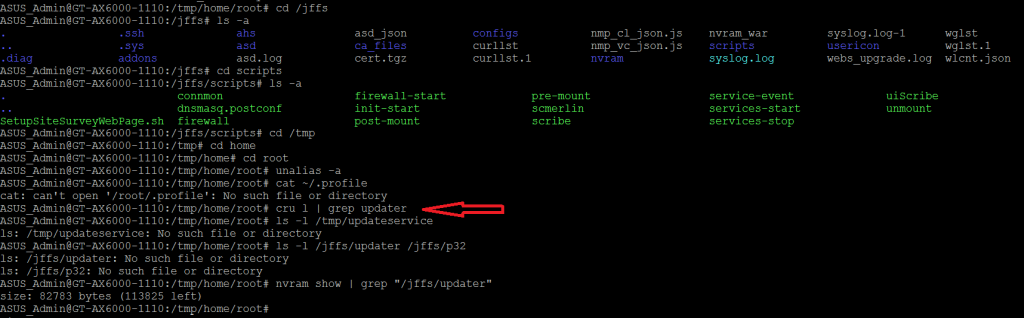

Sorry for the dumb question but how would I know if I have this malware? I'm using AiProtect and Diversion. Am I affected?
From an earlier posts (here) it appears using SSH, the "ls" command, might not show the directory/file(s), but WinSCP may.
I saw it using htop when the script was running, and I was able to access it manually using winscp directly to /jffs/* directory. I couldn't see it in ssh as @ColinTaylor pointed out it highjacks the ./profile so that file appears invisible using "ls" per terminal session. I also saw it when using the cru -l command to investigate the crontab.
That won't help if you're infected. See post #50 for why.
You need to run the following command first. Then you can use ls, cat and ps.
unalias -a
cat ~/.profile
cru l | grep updater
ls -l /tmp/updateservice
ls -l /jffs/updater /jffs/p32
nvram show | grep "/jffs/updater"

"ls -a" seems to show the hidden files.
You would have possibly seen a file called "updater" under your /jffs folder... looks like you're clean.
unalias -a
cat ~/.profile
Are your second set of commands each a different method for detecting the exploit? Do all require running the unalias command prior?
You only need to run the unalias -a command once per terminal session before you enter one or more of the following commands.
Each command looks for a different set of changes made by the script in post #1. So for example, ls -l /jffs/updater may not return anything (other than an error) because asd has already removed it. However, cru l | grep updater may still have an entry present indicating that you were infected at some time.

Has anyone actually confirmed that the asd definition is able to detect this malware? When I had to hard reset the malware was very much active in my setup with no visible indications of intervention from asd. I am pretty much ready and willing to submit a corrupt saved copy of jffs to asus if will help them develope a security definition which will prevent this issue from happening to other users.
I deliberately created copies of /tmp/updateservice and /jffs/updater and asd successfully detected and deleted them. However it look quite a few hours because I think asd only scans once a day. If you killall asd you can force it to restart and scan immediately.
I think it would be a good idea to send what you have to Asus. It certainly wouldn't hurt.

I am so glad @ColinTaylor is around this forum. He gave the best advice in regards to dealing with the issue. A complete factory reset reconfigure took care of everything. While everyone else had great technical angle feedback, @ColinTaylor gave the best upfront initial advice. I hope others around this community take inspiration from him. I was completely humbled by his ability to get in there and give the best advice without soundboarding off of 20million different possibilities. He is straight and to the point. He has my utmost respect.
