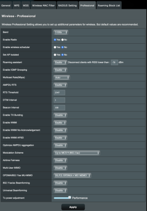

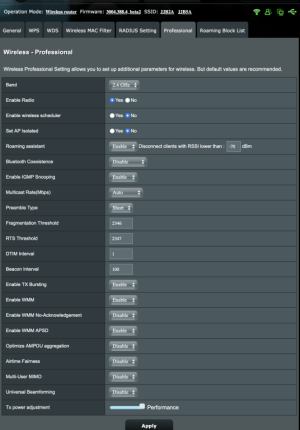

I had them on 5GHz, now switched to 2.4 to see if it makes a difference, I have dedicated channels for the 2.4ghz and 5ghz SSID's and these are my Wi-Fi settings below (I have just enabled IGMP to see if it helps). I have kept my devices/HomePods on the same SSID (they are separated between 2.4 and 5 with different SSID's)
2.4GHz
5GHz

IGMP snooping can actually interfere so I'd leave that off.
How is the signal strength on the devices - you have roaming assistant enabled, maybe it is kicking them off?

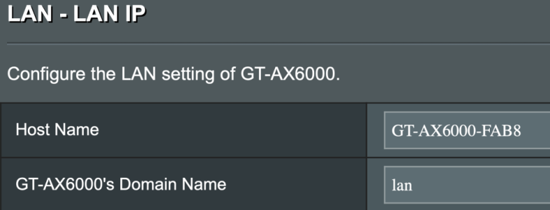

EDIT: Should my router be .lan and not .local? I did change the domain name to lan in the LAN tab.

Do not use .local on the router! Will definitely cause MDNS problems.

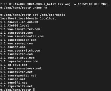

I have changed it to lan, but it still showing as .local. I have clicked applied, and rebooted the router.... host file is below, is this actually correct?
.local is automatically assigned by mDNS, and will be separate from the DNS FQDN that you defined as AX6000.lan.
