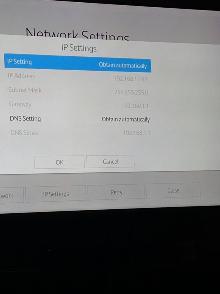

I can't seem to enter an IP address that works. Connecting to wireless is fine btw.
See picture of current settings on the TV screen set to obtain automatically. Maybe a clue there...
