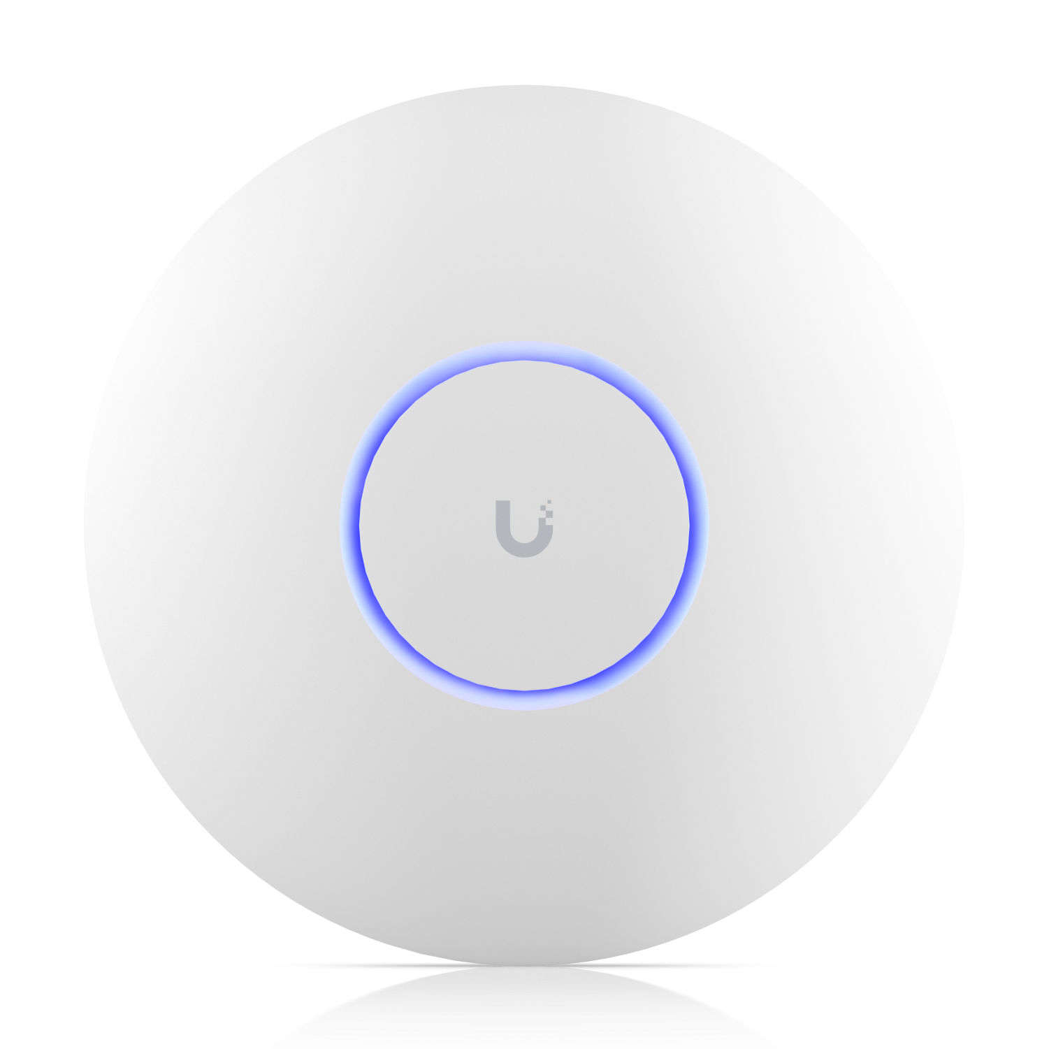

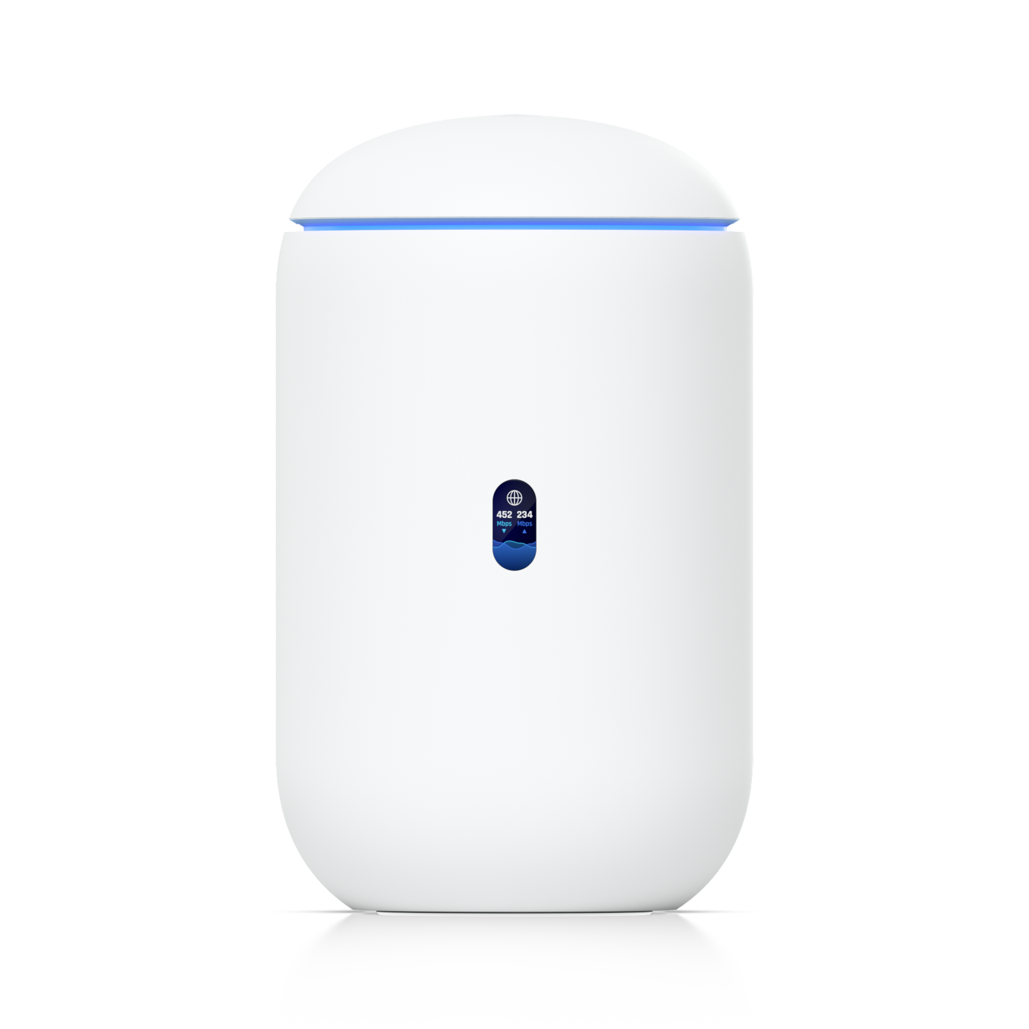

As hardware example - I'm planning Ubiquiti Dream Router + 2x U6 Pro for a new location. UDR has integrated 4-stream Wi-Fi 6 AP, 2x PoE ports and network controller. U6 Pro are matching PoE powered 4-stream Wi-Fi 6 APs. This makes complete UniFi system with 3 devices only, single power supply (will be UPS backed up) and minimum deployment time. This setup is good for up to 700Mbps Internet line with full features enabled, has 2x extra Ethernet ports for further expansion (switch, more APs, bridge, cameras, etc.). UDR can support 20+ UniFi devices, more than enough for home application.
