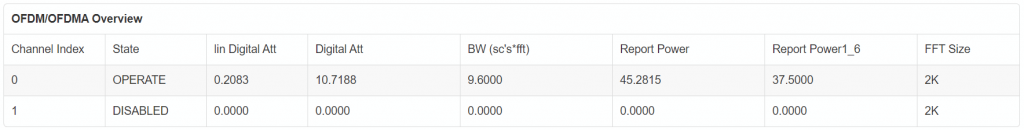

Here is what I found
FW version: 7.1.1.33

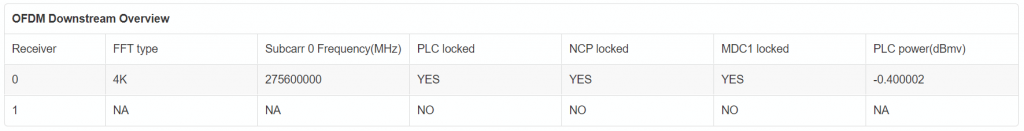

in OFDM secions of WAN:
So I take is OFDM is enabled on modem?

OFDM is downstream, which is fine. That's been in operation for 4 years now. OFDMA is upstream, which is new, and for this modem, is causing problems at the present time. So, you need Rogers to disable the OFDMA (upstream) channel. Possibly by now its just a call to tech support. I'd give that a try first.

Channel IndexStatelin Digital AttDigital AttBW (sc's*fft)Report PowerReport Power1_6FFT Size
OFDM/OFDMA Overview
0OPERATE0.202310.96879.600045.031537.25002K
1DISABLED0.00000.00000.00000.00000.00002K
Those numbers look ok. Only problem from what I can see is the upstream OFDMA channel being enabled at this time.

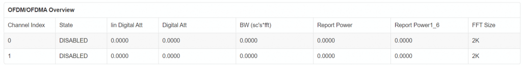

I suppose my last call to Rogers did work - this morning:
OFDM/OFDMA Overview
0DISABLED0.00000.00000.00000.00000.00002K

@Datalink, I owe you coffee/beer!
Disabling OFDMA seems to be fixing the issue - been many Teams/Zoom/Skype calls - not a single glitch so far!
