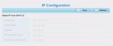

My Foscam R2 IP camera is kind of behaving very strangely after I upgraded its firmware to the latest.
I regretted of doing the upgrade since there is no way I could downgrade back the firmware now. :confused:
I have already configured the RT-AC86U router to assign a fixed IP address to the Foscam IP camera.
It is IP is 192.168.88.239. I can reach the IP camera web GUI without a problem.
I have blocked the internet access from the IP camera.
The IP camera is configured to get its IP automatically from the router's DHCP server.
But it constantly sending DHCP requests NON-STOP to my router.
Do you think my camera has been hacked?

If I enable internet access, I am still seeing: DHCPREQUEST & DHCPACK
Why don't you just assert the IP address you want into the R2 and see if the traffic stops.
That's what I do with all my Foscams--give them each their own fixed IP. I also assert a different Port number and have port forwarding set-up in my own AC86U so that I can see the cams from my phone (anywhere).
Thank you. I gave a static IP address to my IP camera. Result: No more DHCP requests logged.
