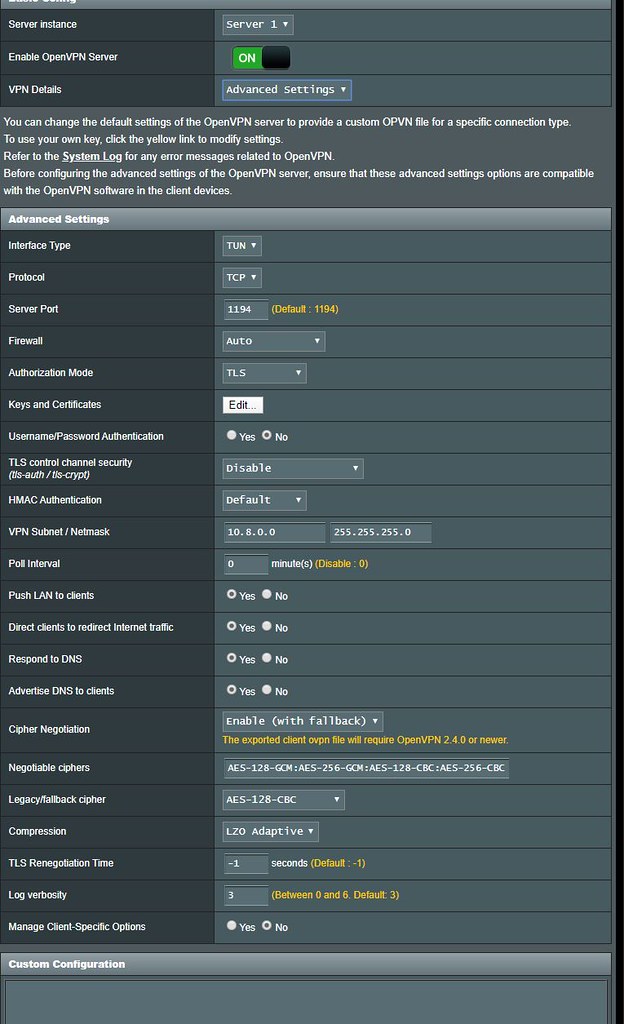

I created the keys and opvn file for OpenVPN sometime ago and it has worked fine on Merlin for some years. I hadn't upgrade my firmware for a while and was still using v382. I decide to update to the latest firmware and manage to get everything else like my IPv6 working fine but can not get OpenVPN to work with my previous keys.
I have tried this with both an RT-AC68U and my current RT-AC86U even doing a full reset and it is exactly the same outcome.
Is there any way to get v384 working with my old keys/.opvn?
Here are the working settings when using v382

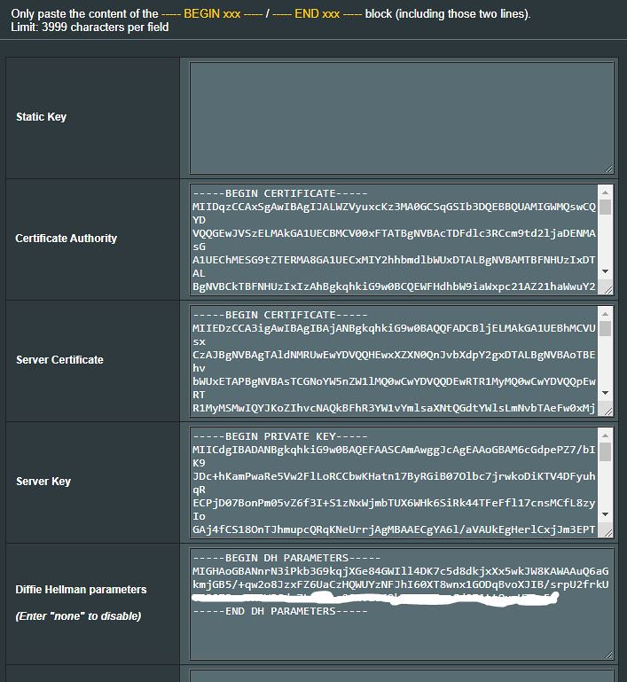

You are probably on obsolete certificates.
https://forums.openvpn.net/viewtopic.php?t=28586
Thanks, this sounds like it is the case as if I use newer v3.07 OpenVPN connect client on my android phone then it fails to connect. I have to use older v3.05 to connect to the OpenVPN server running on the older v382 firmware.
I suspect the only way is to create new server and keys using the latest firmware. I haven't done this for a while so time to do some reading and research again.:)

The config file isn't the primary issue, the VPN server is not working with the old certs and keys. I have to get the VPN server setup correctly in the first place and then generate new config file.

Yes you are missing something. I created the crt, keys and .ovpn years ago when you had to do in manually. I've used the same files for years through different router upgrades (N66U, AC66U, AC68U, AC86U) and different Merlin firmware upgrades. It has all worked perfectly up until the last upgrade due to the changes and improvements in OpenVPN, it is also now much simpler to setup.
I have it all setup and working again now, so thanks for your help.
