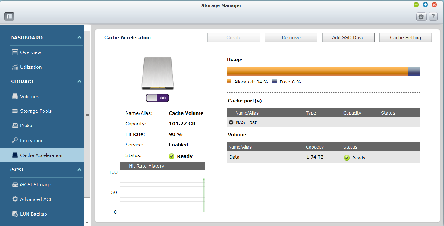

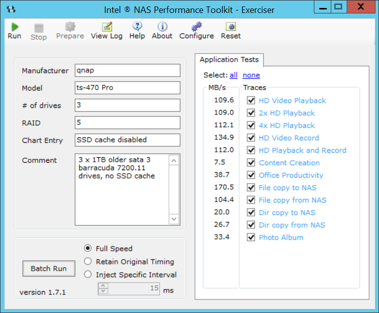

There were a few questions regarding SSD caching and NAS floating around the forum. Here's Qnap's TS-470 Pro over 10 GbE with and without SSD caching. I purposefully used three older Barricuda 7200.11 series drives (sata 3) in a Raid 5 array, with the final TS-470 slot taken up by an Intel 530 SSD drive..around 450 MB/s read/write.
I don't see any performance numbers? Are there more images coming?
