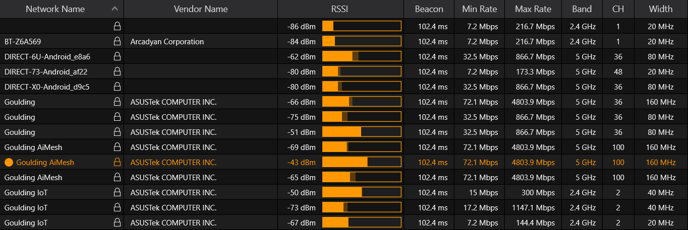

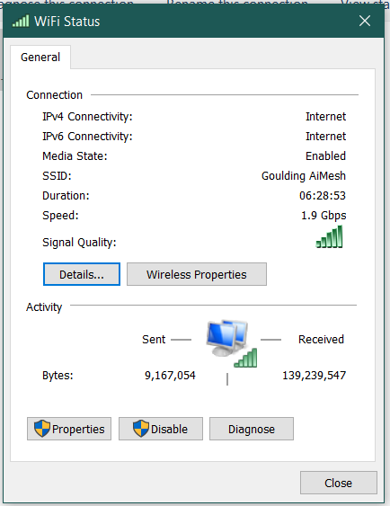

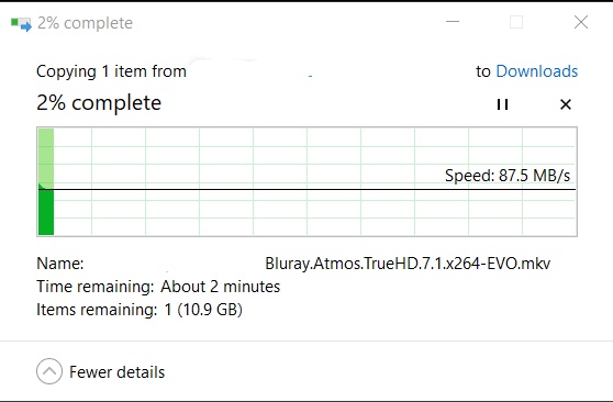

1 - While working in mesh mode it does use 5ghz-2 as a dedicated backhaul yes, but you can unhide and use it for other clients too.
2 - GT-AX1100 - I currently use this in conjunction with 2 RT-AX92u's in AiMesh Mode
Here's a screenshot of the linkrates you can expect from all 3 devices: Note the higher link rates are from the AX1100 and my laptop is currently connected to one of the 92u nodes on the AiMesh network with a 1.9gb ax connection
And real world smb transfer speeds off a slow old NAS connected to the main router via 1gb ethernet while a family member is streaming a 4k video off my main nas via the goulding network on the same mesh node:
Overall, I'd say speed wise the ax1100 is worth it if you have needs of transferring lot's of data via wifi.
