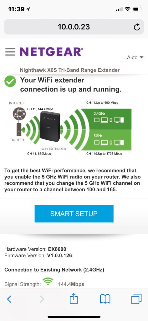

Last week I setup 2 Netgear X6S Mesh Extenders in daisy chain for a client that wanted to extended the signal from an existing Netgear Nighthawk router on the north side of their house to a guest house about 150’ away to the south.
I put one X6S in a window on the south side of the main house about 50’ from the router, the other X6S was in the window on the south side of the guest house about 150’ between the two so they could see each other.

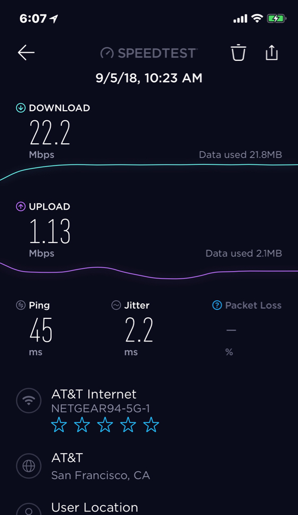

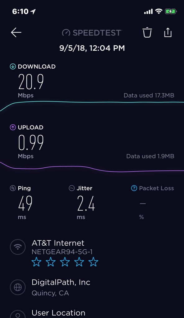

Top screenshot was taken near main Netgear Nighthawk router before extenders were setup. Bottom was taken in guest house near last daisy chained Nighthawk mesh extender after setup. Speeds were virtually the same. I also did a speed test on a wired computer connected to the Nighthawk router (not pictured), and speeds were similar.

They’re in a rural area likely near the end of a hybrid fiber internet cable. I think their plan is 25x5, but on a wired connection at the AT&T gateway they average 22x1.5
Yeah, there’s a degradation of about 10% 2 extenders away from the source, but that’s nothing near the 40% average degradation you get from a regular extender that doesn’t use a dedicated backhaul radio.
