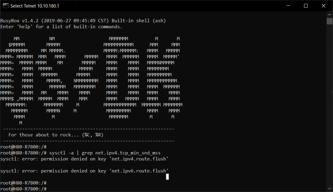

Try to check in telnet console:
sysctl -a | grep net.ipv4.tcp_min_snd_mss
if this command displays nothing then kernel vulnerability is rather not fixed (or at least fixed partially) . If you see:
net.ipv4.tcp_min_snd_mss = 48
it means that CVEs are fixed.

Just FYI results of command:
R7800 1.0.2.68SF:
sysctl: error: permission denied on key 'net.ipv4.route.flush'
sysctl: error: permission denied on key 'net.ipv6.route.flush'
R9000 1.0.4.32HF:
sysctl: error: permission denied on key 'vm.compact_memory'
Debian 9 (Stretch) x64 , PC, with all CVE fixed:
sysctl: reading key "net.ipv6.conf.all.stable_secret"
sysctl: reading key "net.ipv6.conf.default.stable_secret"
sysctl: reading key "net.ipv6.conf.eth0.stable_secret"
sysctl: reading key "net.ipv6.conf.lo.stable_secret"
Voxel.
