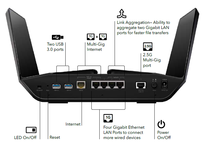

So apparently I'm going to receive that RAX200 by post today, the shop will deliver the order after all, despite weird stock information (after I ordered, the item in the shop shows available in April, 5 months later).
I see the specs and the ports here:
https://www.netgear.com/home/wifi/routers/rax200
So, it has no adsl port (which I expected).

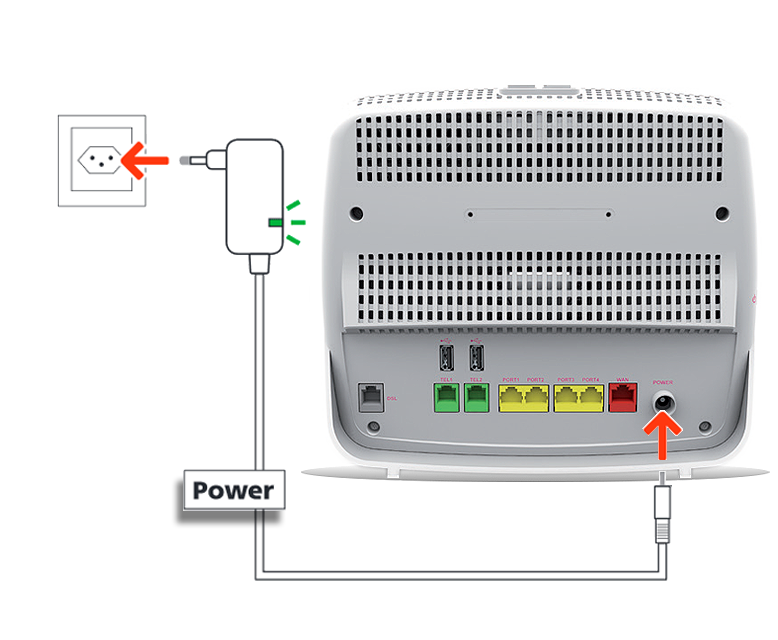

I have a crappy ISP provided modem, lets call it A:
https://www.sunrise.ch/en/residenti....html?page=device/modems/sunrise-internet-box
I have currently B (R7000)
I will have C (RAX200).
I'm quite familiar with configuring these devices, but my network layout was/is stupid, and maybe it's time I invest some efforts in fixing it.
I can't configure that modem to be in bridge mode, there's no such option. Ideally I would get rid of it, or render it only useful for the modem feature. I don't want to inve...waste money in getting a basic modem.
What I would like is to only use the RAX200, I have several devices cabled, and several using wifi.
I think the way forward would be:
1) connect the RJ11 to A
2) connect a RJ45 cable from A WAN (red) to C WAN (yellow)
I'm not sure if I'm supposed to disable anything on the A device, turn off DHCP, etc... or simply the fact that it's connected only to WAN and to the router C, it will use none of the features?

Yes, the problem is I don't want the crappy device A, to be the router.
I just had a call with the ISP, who told me bad information (I did found it suspicious last time), about the WAN port.
They claimed that to bypass the "router" and only use A as a modem, I had to connect WAN to WAN (A to C).
Now I called again because when I want to select the internet source from C (the RAX200), it asks for the credentials to login to the ISP. The poor support don't want to give them to me (they are understanding very little anyway). That's when now, they told me we should never plug anything to the WAN port of A. Then I saw one of their illustration on their support page, and apparently, WAN port for them is reserved for a setup where there is a "optical wall plug" (fiber?) and some converter device. See page 127, there is an illustration: https://www.sunrise.ch/content/dam/...anuel_Sunrise_Internet_Box_new_firmware_f.pdf
Clarification: So it seems that WAN port is intended to input XXX to the device A, and not to "output" the internet connection to C, bypassing the routing feature.
I have ADSL, or I should say VDSL.
For many reasons, including double nat, I want to simplify and use that A device as modem only, or with reduced functionnality, without having to bother much in its crappy interface...
Even UPNP is poor on that A device...

I had to change things a bit.
Long story made short, the ISP does not let me use any other device (well they don't provide any login information and/or any help).
I ended up having to use that junk device.
So it's currently like this:
Device A (ISP modem) port 1 to Device C (RAX200) port 1 (=Lan to Lan).
Device A has static ip x.x.2.1. That also serves DHCP
Device C has static ip x.x.2.2. DHCP is off.
My pihole is connected to Device A (static ip x.x.2.3), and the DNS server is set to that + port redirection of dns to x.x.2.3).
That setup works but sucks, for example, the RAX200 is now dumb, and won't even detect it's connected to the internet and won't firmware update (I can only do offline updates).
I guess I could have done LAN TO WAN, but then the devices connected to device A would not connect, and I would have needed more RJ45 cables to put then to Device C...
Well for now it's going to be like that, since the bridge of DVC A is not possible and I can't even replace that dumb device (for now).
