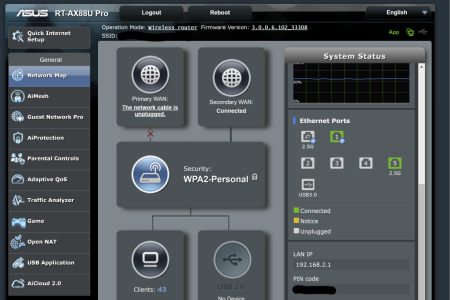

For almost the past decade I've been using an old ASUS RT-AC87R with no issues. One of the antenna broke on it so I decided I would upgrade to the Asus RT-AX88U Pro. When setting it up it immediately showed the WAN port light as red on the top of the router and in the control panel it says "The network cable is unplugged." Also, on my modem (Pace 5268AC supplied by AT&T) the ethernet port does not light up when connected to the WAN port. I tried a bunch of other ethernet cables with no luck and spent a few hours trying to troubleshoot. I finally was able to get my modem to see the router (and vise versa) but enabling Dual WAN mode and setting up the fallback to connect to the LAN 1 port on the back of the router. Since that worked I assumed I had a faulty WAN port and ordered a new router. The new RT AX88U Pro showed up a few days later, I hooked it up and immediately got the same red light and the same issue where it says the network cable isn't plugged in. So I'm thinking this is some config setting that is wrong?

I'm confused because it works with the WAN port on the older Asus. The only difference really with this new router is the WAN port is the WAN is now a 2.5Gb port. Would that somehow matter? I have normal DSL internet, not fiber or anything.
Once again, note I do have the router / internet working via the LAN 1 port on the Asus connected to any of the LAN ports on the 5268AC, but I want to fix the WAN port.

Most likely your modem doesn't play nice with 2.5GbE ports.

Oh man, I feel dumb for not trying that. I actually had a spare switch and stuck it between the two and it works now. I'm amazed Asus doesn't have that in any of their FAQs or troubleshooting. I also contacted AT&T's support and they didn't mention it either.
