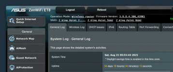

My experience with the ET8 has been very positive so far. In fact, it has been rock solid now for 34 days. I use default settings.
