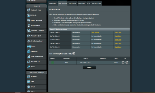

The router has System Log. If the VPN Client can't connect the System Log will contain messages with the reason why. You are using Asuswrt-Merlin 3rd party firmware and Asus Support have nothing to do with it. This firmware by default routes nothing through the VPN connection. In VPN Director you have to specify what is using this VPN connection. More information here:

I tried above but still no go. I can access the system log and run it and read it but it doesn't make much sense to me. I understand ASUS don't support AsusMerlin as it is third party. I am just a bit out of my depth with this but keen to try and figure it out. There are so many settings to work with in VPN. If I send through the system log and screen captures of the configuration would this help or am I pretty much on my own to try and sort it out. I am new to the forum so just let me know the protocol.
Copy/paste OpenVPN related syslog messages in a text file, make screenshots of your GUI settings. Attach both to your next post and someone may be able to spot the issue and give you advice what to do. Also mention what do you want to use the VPN connection for, network-wide or specific clients only. Keep in mind your router can't do OpenVPN faster than ~180Mbps.
If all the efforts are about privacy and security - one of the many discussions about commercial VPNs here:

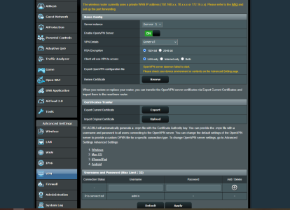

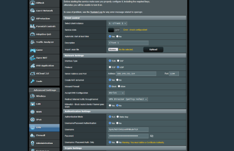

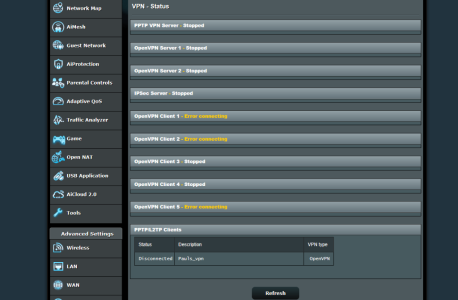

Hi Tech9, Thanks so much. I have attached the screen shots and also the system log I just saved. My intended use of VPN is for network-wide application.
Hope someone can help I have burnt probably 20 odd hours on it so far. I had three other captures but can only load 5 if others needed I can send those as well.

You have "Username / Password Auth. Only" set to Yes when it should be No.

Those should all be set correctly from the .ovpn file that you import. The only exception would be if the VPN server pushes IPv6 parameters (and you don't have IPv6) in which case you need to add the following lines to the Custom Configuration box.
pull-filter ignore "ifconfig-ipv6"
pull-filter ignore "route-ipv6"
As far as I know NordVPN doesn't support IPv6 so the parameters above are not necessary.

In this case fix the connection with certificate and make a subnet rule. One of your screenshots showing VPN Server is unrelated to your VPN Client issue. For network-wide application expect WAN speed drop to 160-180Mbps (depending on server load) and increased latency. Also expect applications complaining about traffic going to/from commercial VPN. Good luck!
