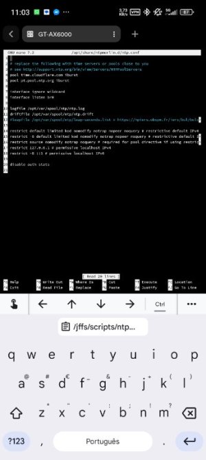

Thanks for your help!
Attached is my config file.
'sh /jffs/scripts/ntpmerlin generate' doesn't generate any output.
When doing 'sh -x' it loops that output 25 times.
Please tell me if you need more info 💪🏻

Frankly, your screenshot is unreadable and therefore unhelpful. One has to squint their eyes very hard to try to read the relevant information, which takes up less than ~40% of the screenshot. As a result, the majority of the image ends up showing useless information, relegating the pertinent data to a small area of the screen. I'd highly recommend learning how to take better screenshots.
