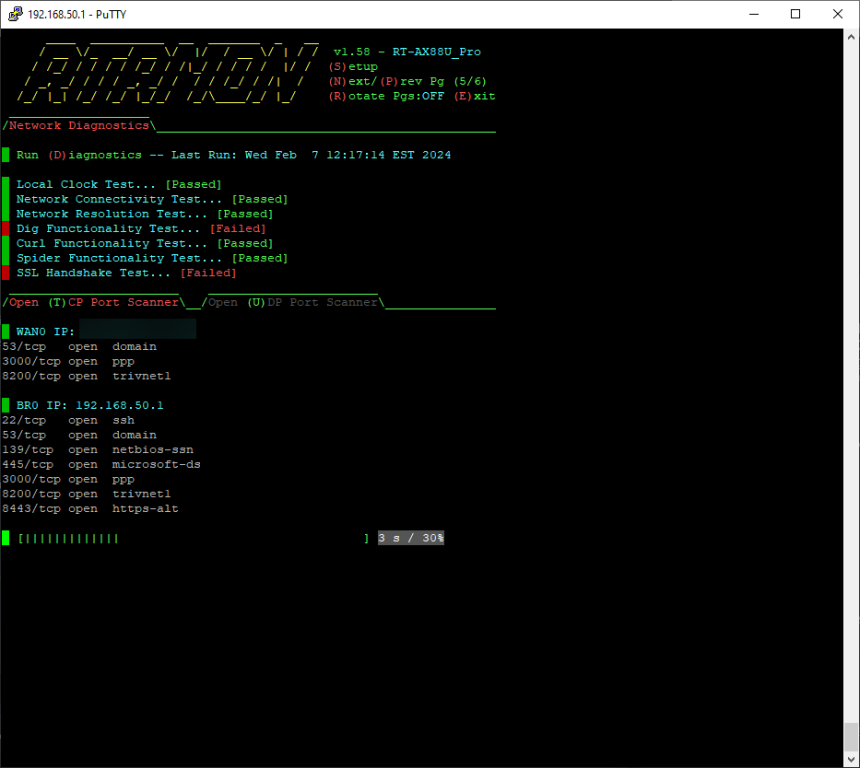

In addition to what @ColinTaylor said, you can also utilize the portscan feature in the RTRMON app (available through AMTM)... it uses nmap to do a tcp/udp portscan against both your WAN and LAN interfaces and shows you what's still open.
I just ran this and nada
I had no idea this tool was in AMTM thank you.
But now I need to investigate those two failures Dig Functionality and SSL handshake Test
Dig might be failing because you don't have dig installed through Entware... The SSL handshake test tries to make a connection with 8.8.8.8, so if you're blocking that, you might get a failure as well.

Looks like it's failing on mine too actually... I need to update that nc statement... I will get that out in a new release out shortly. It's not you... ;)
Here's the statement:
nc -w3 8.8.8.8 443 >/dev/null 2>&1 && echo | openssl s_client -connect 8.8.8.8:443 >/dev/null 2>&1 | awk 'handshake && $1 == "Verification" { if ($2=="OK") exit; exit 1 } $1 $2 == "SSLhandshake" { handshake = 1 }'
echo $?
If it returns 0, you're good. :)
