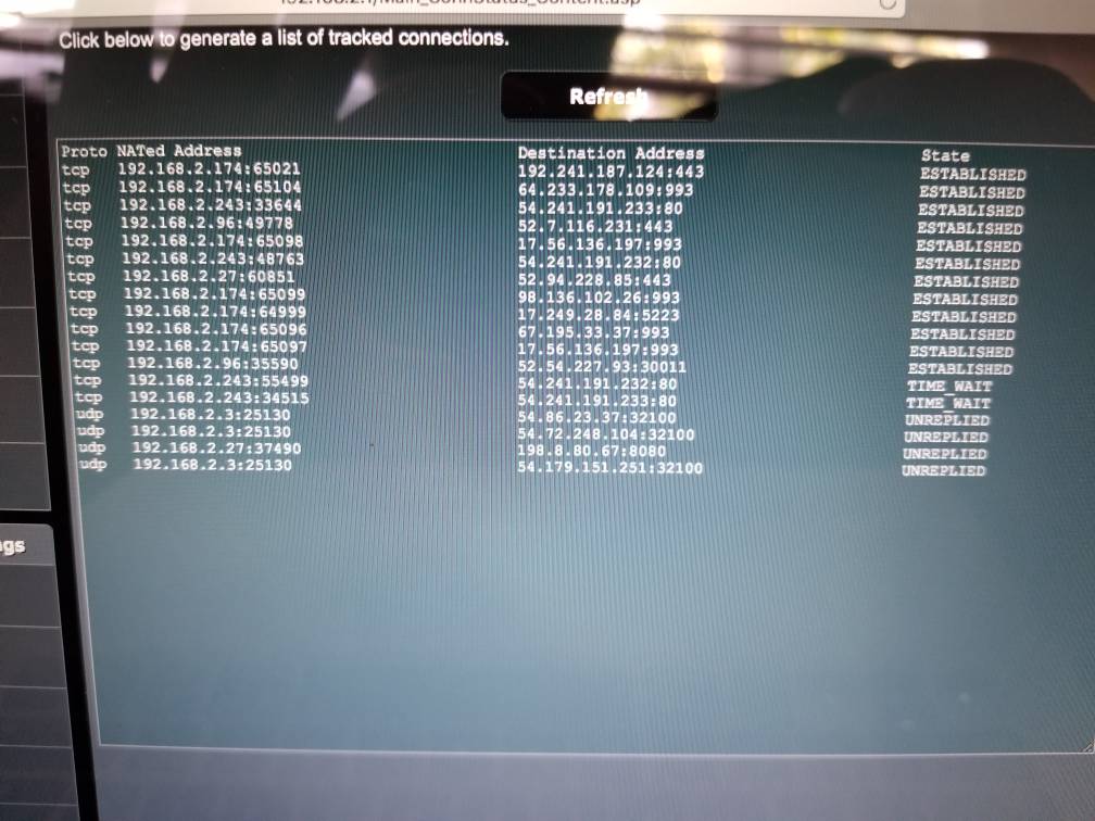

Possibly been hacked. Need assistant from senior users.
Here is the syslog along with other photos of the current configurations.

There's not a lot to see in your syslog for that period. We can see the PPTP and OpenVPN (were you using OpenVPN?) servers starting as the router is rebooted. There were a lot of disk errors prior to the reboot so I'm guessing that it was you that rebooted it? If that is the case then it's possible that the VPN changes were made at an earlier time but only became active when the router was rebooted.
Everything else looks normal. Given that the latest firmware has patched some vulnerabilities I don't think there's much more you can do at the moment other than updating the firmware and changing your router password (and disabling WAN http/s access of course).

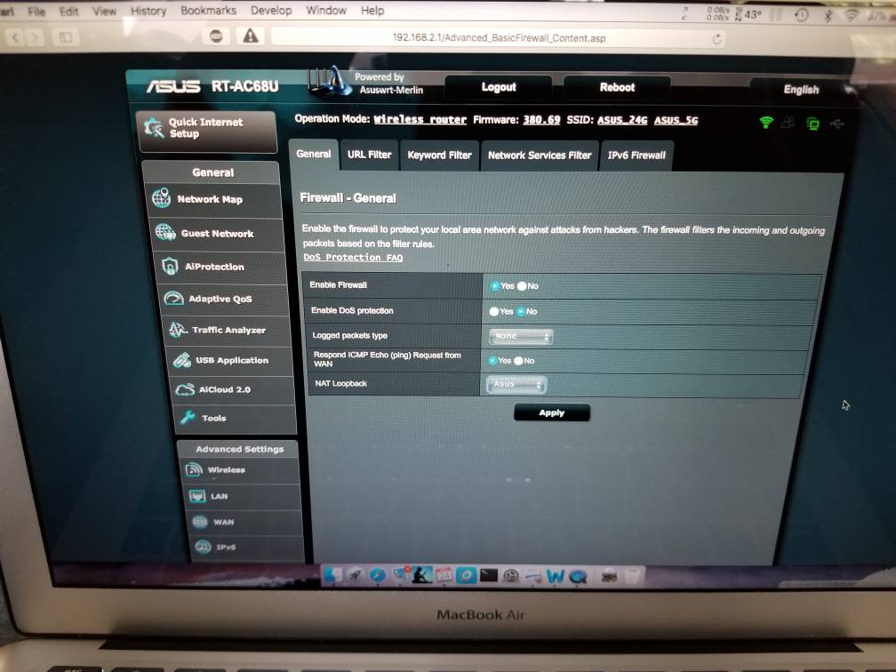

Also for starter, you are not running the latest version. There were a number of security issues fixed by Asus and myself since the 380.69 version you show in your screenshot. The first thing to do is to update to an up-to-date version.

Addendum: I see you have AiCloud enabled. That's something that is open to the Internet. Asus has fixed a number of security issues in it over the years. AiCloud being closed source, I can't tell much more about it, except that I don't fully trust its security either. It's possible that it could have been used as an attack vector since you aren't running an up-to-date firmware.

They got into the router, assigned their PPTP VPN, shut down my VPN and enabled AiDisk. They were after my 1TB attachment.
Luckily, AiDisk doesn't work in a multi-nat environment, so their effort wasn't fruitful.
