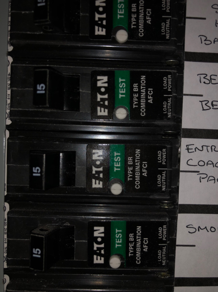

I have not looked to see if I have breakers with Arc Fault detection, I would check today.

It's not quite as simple as that. AFCI breakers are more likely to be an issue than non-AFCI but some are OK and some are not. Only way to find out for sure is to test them yourself. Buy from somebody with a good return policy and check it out. Make sure you are using the latest gen products
Those are the one, are those compatible with the powerlines?
Yes - if you cross circuits - AFCI breakers are going to be a challenge with powerline...
Used to be that ground-fault interruption benefited bathrooms and the kitchen, but many areas have mandated AFCI breakers for the whole home - it's safety things, and electrical CODE...
Yea it seem that all the room have them now, the only one not Having them are the big appliances.
