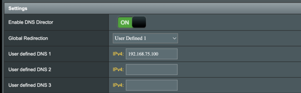

If I do indeed enable DNS Director... does it matter whether I set it "Global Redirection" to to the Router IP address (and under DHCP tab, I have the DNS set to the IP address of the NAS running Adguard Home) or whether I set it to "User Defined" and specifically put in the NAS IP address?:
Under DHCP Tab:
(192.168.75.100 is the AdGuard Home running on NAS)
Under DNS Director Tab:
Option 1:
Option 2:
And of course no redirection for the NAS:
Does it matter to do Option 1 or Option 2? Will one option versus the other give me more accurate logs?

Something is not configured properly. I've tested both on-router and on separate device AdGuard Home configurations and they both recognize local network clients. My last test with on-router configuration is here:
https://www.snbforums.com/threads/a...staller-amaghi-cont.79862/page-17#post-878594
When your AdGuard Home runs on a separate device you need to exclude this device in DNS Director. Global - Router, AGH - No redirection.
You guys have to understand the difference between the two configurations. It causes confusion quite often. AGH settings difference as well.
Yes they do recognize network clients, but NOT ALL. It isn't like the WAN setting where ALL traffic seems to be coming from the router, but with DNS Director On (and yes, No redirection on the separate device), it will still show the most active client as the Router itself.

Thanks for that link. Maybe it has to do with the AGH settings on the NAS (specifically, what I need to select as the "Upstream DNS Server").
