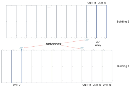

I'm inserting a basic map of the new layout. I'd love to go with three antennas if possible as Antenna B is where our primary router will be. The longest distance between two antennas (A and C) is a little under 150'. We've got network drops beween units 14-16 on Building 1. They buildings in Simi Valley, California.
I'm looking for recommendations as to the best (stylish?) antennas to use that will give us the best throughput. I am not sure about how Meshes work, really, so I'd love to do a Mesh if that's practical. Right now, they have two ASUS AX88Us running in Building 1, Unit 14 and Building 2, Unit 14. If there are better units to support the new topology, I'd love to hear them too. Can't break the bank, however...
