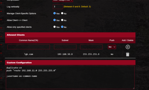

i do have the site to site rule in the server and it is working...
ie the server side can reach the 192.168.50.x network (at least with the older client router i am attempting to replace) ie

Is 192.168.11.0/24 the actual IP network on which the OpenVPN server is running? IOW, it's NOT the case it's running on (for example) 192.168.2.0/24, but 192.168.11.0/24 is simply reachable from 192.168.2.0/24.
I'm suspicous because the server would normally automatically push its own IP network to the client (at least w/ Merlin firmware). You shouldn't need to specify it explicitly in Custom Config. You would only add it to Custom Config if it was some *other* reachable IP network.
yes that is the network it is running on..

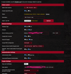

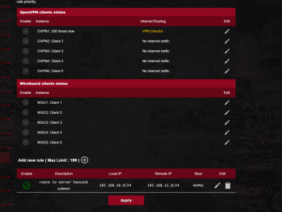

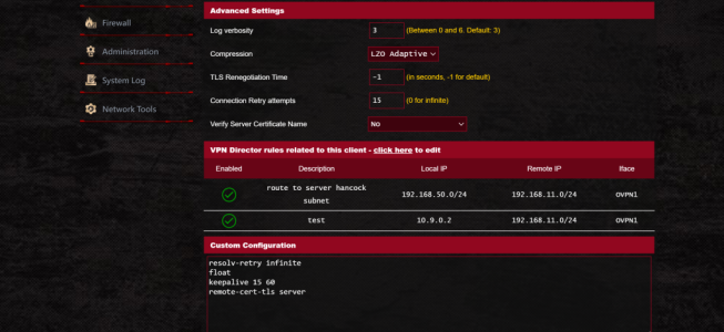

anyway i got it working as i said using the vpn director from what i am reading here are the two sides..
without the vpn director since i did not select redirect internet traffic (set to no as i dont want all traffic going over the vpn) as i said i had only connection to the single server 192.168.11.1 and nothing else and from that side nothing could reach me.
thanks for your help..
and i now can reach the 10.9.0.2 from the server 11.0 subnet and also becuase of the route added i s the allowed clients can reach the entire 10.0 subnet which is behind my starlink cgi (pain in the butt) nat.
thanks again
