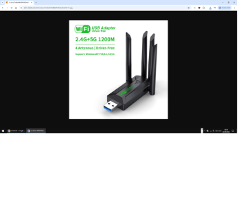

In this adapter with RTL8811CU chipset, does the positioning of the 4 antennas have any influence on Mbps loss or gain?

Usually no. There is no penalty for playing with them each time you move around.
What matters more is what is around the antennas or not around the antennas or what is between the antenna location and the AP.
