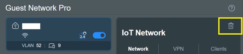

For context, which router are you talking about, RT-AX86U or RT-BE86U? For the 3006.102.x firmware there is a delete icon (trash can) in the upper right of the Guest Network Pro profile.
For the 3004.388.x firmware there should be a disable option for the Guest Network. You can always change the SSID and passwords on the Guest Network if you decide to enable it at a later time.
