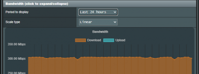

ISP speeds seems steady to me, also have spdmerlin running wich shows the same line.
Sometimes a little bit lower but this could be due to me being in teams meetings at those moments or anything else work related.
I do a speedtest every 30 minutes from spdmerlin.
Small dip at 22:15 from the left adds up to the time yesterday evening i was working for a short period and downloading some stuff for work.
The a steady line during the night and you can see its start to fluctuate a little bit again when my kid woke up this morning and started YT before school at 07:45.
And then during the day my work shizzle, being in team meetings taking a little bit away and downloading other things for work.
