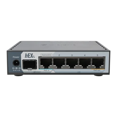

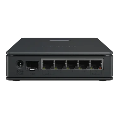

Use the asus machines as APs.
Seeing your signature, you may be reluctant to lose the scripts, but you’ll soon see that the core functionalities can be found elsewhere
You don't need to change anything, but get 2x GT-BE19000AI to make ASUS happy. 🤭
If you would like to provide the funds, I would be happy to place the order :D
Whats the point in replacing Gigabit ASUS with Gigabit MikroTik? Both can’t make 2.5GbE speed test anyway…
