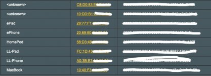

I am on an RT-AX86U, with the latest version of Merlin. How would one go about looking to see if the router can write to the files?
Looks like the router resolves the names.

That‘s the MAC address, not IPv6 address. Diversion does not have that info.

The system log on my router has the same information. There are three columns:
Hostname / MAC Address / IP Address (which are IPv6's)
My router shows information in each column for devices.
Referring to System Log / IPV6 tab
After you’ve viewed the tab in the GUI, you could find the info in /tmp/ipv6_client_info. The GUI collects it by running the equivalent of ip -f inet6 neigh show dev br0 | grep lladdr and parsing the MACs with the host details.
