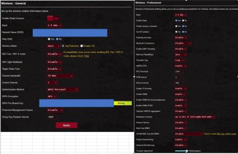

To recap: I have 3 ESP8266 devices that have worked reliably for 5 years before getting my GT-AX600.
To increase my sample size for diagnostics, I also did some work on the 4th, which is further away & always used to drop connections occasionally.
I then rewired the third so it sits near to the router, like 1&2. I had problems getting this to reconnect. I rebooted the router. This number #3 connected, but the other 3 which were connected before the reboot ceased to function. The ASUS router claimed they were connected, but the devices which WERE working reliably are no longer uploading data.
I rebooted the 3 disconnected ESP8266 devices and it did not fix the issue.
I then rebooted the router again. After this, only 2 ESP8266 devices appear connected. Only one is uploading data.
ASUS UK said I should return the router.
I like the router in all other respects, but my ESP8266 device absolutely MUST run reliably.
Here are my settings is there anything else I should try before returning this router ?
