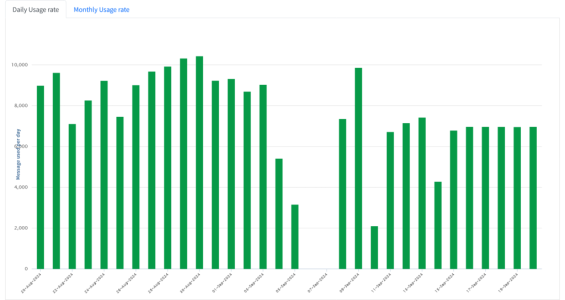

Here's the data. On the 15th of Sept, I switched from the Asus router back to the Vodafone.
I also increased the delay time on one of the 4 ESP devices, to cut the total message count to around 6960 per day.
Just look at the consistency with the Vodafone router. Whereas the Asus had lots of dropped messages almost every day.

Currently, the Vodafone router has kept stable 2.4 GHz connections since I switched back to it. 11 days.
As it stands, I haven't identified an obvious replacement & I'm busy on other things, so the next router is on hold.
Given the paucity of good non-Asus candidates, I don't rule out eventually trying a different Asus model. Next time around, I won't be wasting time trying all the settings changes. Either 2.4 GHz is stable immediately or it goes straight back to the retailer.
